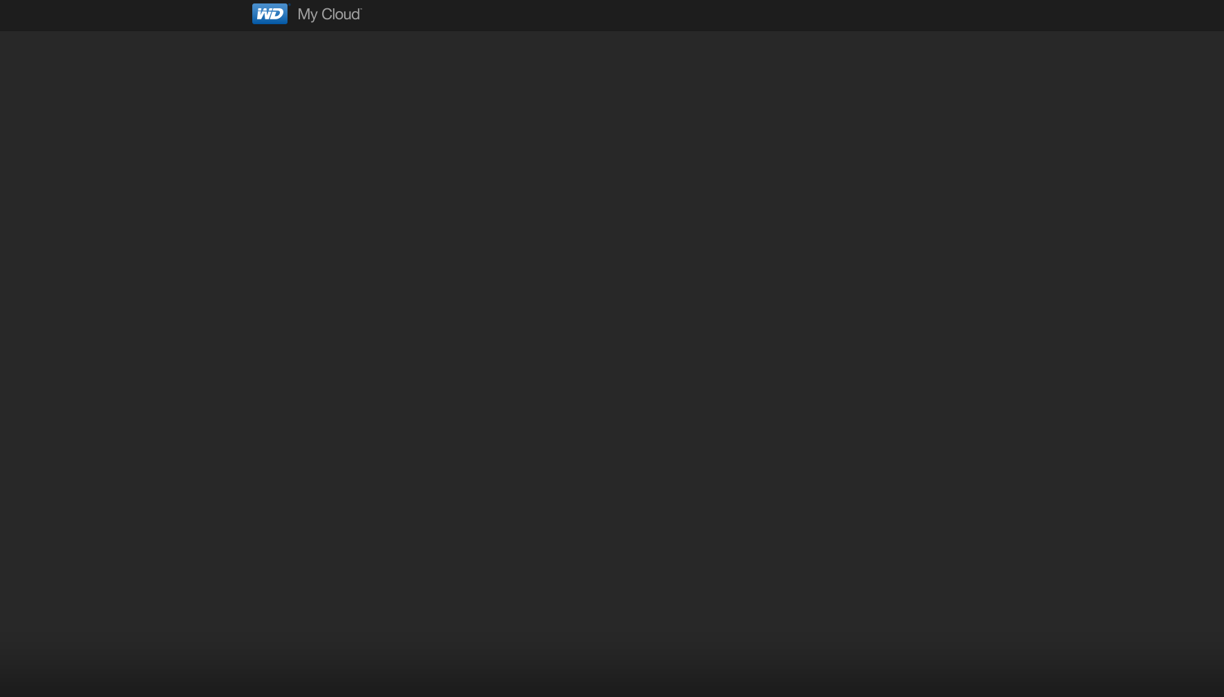

I see My Cloud but my dashboard is NOT loading.
After giving my IP/UI i see that he is connecting and then i see
That is all, nothing more, nothing less :frowning: So, NO dashboard what i see

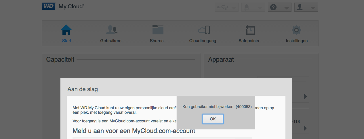

I have to make a NEW MyCloud.com - account. When i give my e-mail, he know me and he don’t accept. But when i give a other e-mail i get the next problem: I translate (kon gebruiker niet bijwerken -
user could not update). But now i can do nothing, i can’t click MORE, i can only stop now.
What do i have to do? I keep my window open :slight_smile:
Hit ‘Cancel’ when it asks you to create a Mycloud.com account; it will skip to the next stage of setup.
Oké, i have done that. Now i see dashboard again :slight_smile:

I keep my browser open for the Dashboard. When i open a other browser to see if i can see there the dashboard too, i get back again a blanco page and no dashboard. I think that is not good.
Now i have it still open from a hour ago. But i think when i will close it i can’t open it again :frowning:
