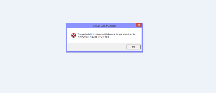

Instead of 6tb under size, it shows O Bytes... Disk 3 Unknown, Not Initialized
when tried to initialize and convert to GPT
“The specified disk is not convertible because the size is less than the minimum size required”.
2tb or higher requires/recommended for GPT… mine is 6tb so i have no idea why windows think the disk is not higher than 2tb.

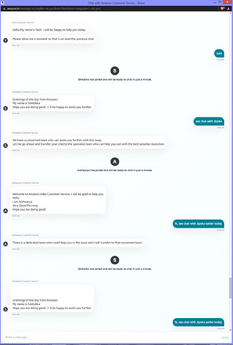

so here is the chat while i contacted amazon.
Note: If images are not visible enough, click on the image and use the Browser’s Zoom feature
As you can see, its Either Amazon purposefully engages in non stop trolling by following the behavior as shown in the above chat example to annoy the customer and make them give up or they just work on replacing human agents with AI bots but human names…? 1 hour of beautiful Sunday wasted…
i was listening to spotify and catching up with playlist updates and was patiently replying to every agent that got in the way just to see where it will end and how it ends… As you can see from the above chat, the experience was terrible.

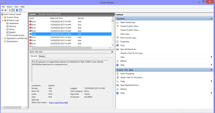

Thought about checking Event viewer and here is what i found
so its a manufacturing defect i guess…

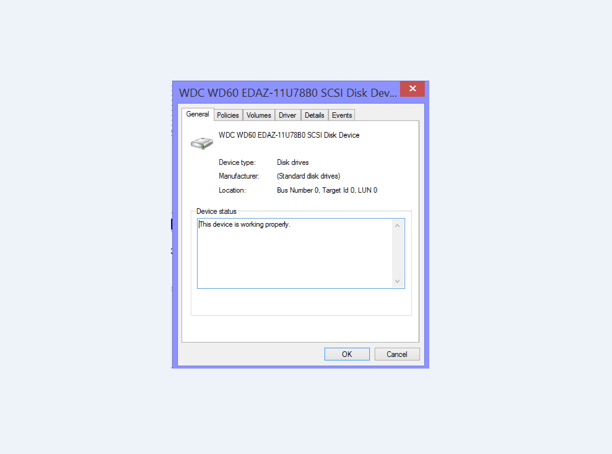

Alright, i have entirely shucked the drive and placed it inside the enclosure…
Now windows shows up the disk name info on the disk management but the problem still persists…
the name of the above image WD60 EDAZ should match the drive image which i posted.
Also, It is showing 0MB, 0 bytes in properties → Volumes

After shucking the drive, Event ID 154 error seems to be gone …Now, a couple of warning seems to be logged
its Event ID 153

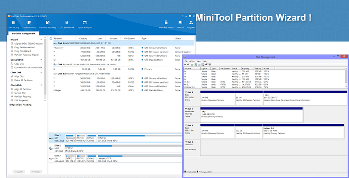

@Cerberus If windows disk management in and of itself is unable to fix/do something, then i highly doubt these 3rd party softwares can fix/do it…
Anyway, I still went ahead and installed it just for you
you can clearly see disk management was able to detect the disk and the Minitool partition couldn’t
Also, here is cmd diskpart error
