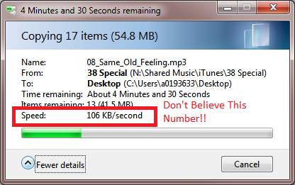

Sure you can’t trust the speed shown in the copy dialog because its some sort of average of the total copied and time elapsed.  However, one always-accurate method is to go to the Windows Task Manager’s Networking tab.
Here is a sample of my MBL speed.
The MBL has a Green blinking light (Gigabit connection) to a D-Link DIR-860L Wireless AC1200 Dual Band Gigabit Cloud Router.  My laptop Ethernet is also Gigabit-capable and the wireless is using a 5.0GHz N connection.
I don’t see why it should be this slow (364KB/s shown) when I’m only 10 feet from both the MBL and the router, and the router consistently provides our paid limit of 30Mb/s (10.5x faster).  I know this hardware is lazily strolling along the internet boulevards with these figures, so the MBL should be faster! Why not?
