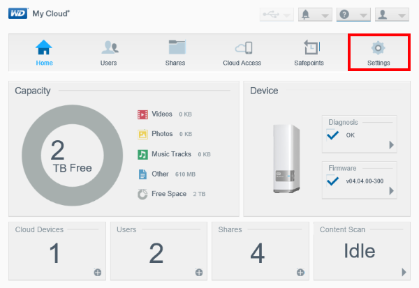

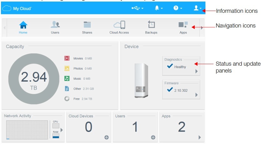

Just to add to the confusion, there are now two generations of single-bay MyCloud drives, which aren’t easily distinguishable to a naïve purchaser. The old, ‘Gen 1’ drives run a version of Debian Linux, and v4 firmware. The newer, ‘Gen 2’ devices are based on BusyBox, and run something called v2 firmware, which appears to be a version derived from their exclusive to Japan ‘WD Cloud’ product, to avoid the pre-existing trademarked MyCloud product there…
The OS used on the first gen (personal) single bay My Cloud, those running v4.x firmware, while Linux (Debain) is slightly different than those running on the gen two single bay My Clouds, those running v2.x firmware that uses BusyBox on Linux. The Dashboard interface is slightly different as well. The v2.x has an “App” section while the v4.x version does not. In certain cases the SSH commands one issues is different due to the firmware folder layout of each version too.
Why WD decided to release a new version, keeping the same name as the old version, yet have different firmware and different user interface is beyond me. Its lead to some considerable confusion on this support site when the end user asks questions but doesn’t provide their firmware version. What makes it worse is they’ve change the name of certain features between the two, like for example; “Safepoint” for v4.x and “Backup” for v2.x for backing up the My Cloud to another location. Then there are major goofs in v2.x Dashboard where WD apparently forgot to code in a Shutdown button even though the User Manual (link below) for v2.x indicates, in two places, that there is a Shutdown button. And the fact that the v2.x “Backup” module doesn’t support a creating a schedule backup either.
Version 4.x firmware Dashboard (generic image from WD):
Version 2.x firmware Dashboard (image from User Manual):
