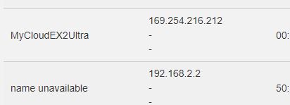

Did the 40 sec reboot once more, which took 12 min blue flashing to solid blue led. Looked for the local IP within mine local net work ( ie 192.168.2.xxx)
To discover an ip address totally out of the local range … (see screen print)
This is the way i want to go however cannot even access the device through local IP orf [mycloudex2ultra] any more.
If the My Cloud is using an IP address like 169.254.x.x that usually means it is not obtaining an IP address from the local network router. One can try to access the My Cloud using that 169.x.x.x address and see if the My Cloud Dashboard loads in their web browser. Basic troubleshooting steps, if you haven’t tried them already. Make sure to connect the My Cloud directly to the local network router if isn’t already. Avoid using network extenders or power line extenders to connect the My Cloud to the local network. Check the network cable and replace if necessary. Try a different network port on the back of the network router.

Have tried the 169.254.x.x…x adres , with no luck as no my cloud dashboard responded.
Have reset the My cloud once more an got solid blue led. Reset the router to close off the channel for this other IP. Tried several tools to discover the My clouds IP on the local net work,with no luck. Device is dead now.
