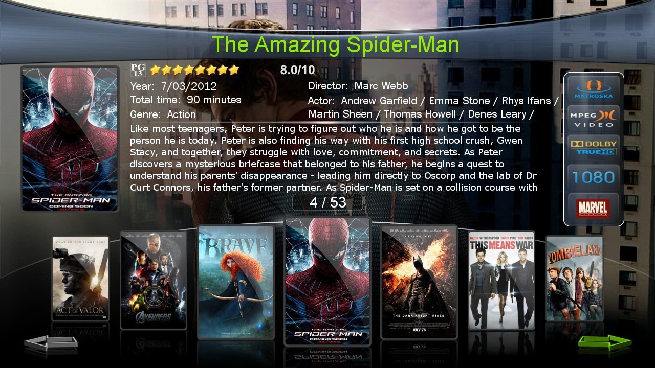

I just installed this now, from the web interface.  Although I assume you used another place to get your box cover photos?  (the pictures with the dvd box included)
I have the Lord Of The Rings movies also.  My Return Of The King has a different graphic, I like yours better.  Also yours have rounded corners, mine are just square.
The movie stats are blank on that screen on the movie preview screen/view, or at least it is for me.
Mine also doesn’t display the nice partial reflection of the box art below each like yours does.
