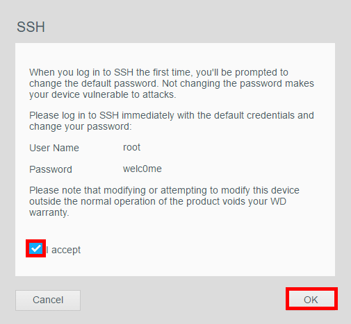

This is a reason, that I want to downgrade firmware to older version, because in the past it was possible to login as a full ‘root’.
You can see it on WD’s pages, and it worked this way before WD’s problems with poor security issues on MyCloud devices:
I looking for a firmware wich allow me to login as a ‘root’ user in console.

The OS3 v4.x firmware uses “root”. WD changed the v2.x firmware a long time ago to use “sshd” instead of “root”. The change happened sometime around v2.31.195 (09/11/2019).
SSH no longer working (update 2.31.195)
You might need to use firmware older than v2.31.195 to accomplish what you are trying to do.
