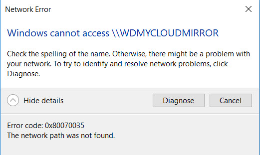

I just turned all of Norton off for an hour and I still have the problem. It is consistent with this message from Windows.
That is a psuedo name, could it be different than others? I will try to see what the psuedo name is on the other systems. Do you know how to resolve that name???
If you haven’t given your MCM another name then that should be the correct one (you can rename it under the dashboard, WDMYCLOUDMIRROR is the default). If you have then that’s the name that needs to be used before the double-backslash.
My suspicion though is the Windows version you’re running on the problem box. MS have removed Samba1 support by default in the newer (1803) builds, and you might need to re-enable it or adjust the settings on the MCM to use a newer version of Samba (2 or 3).
Some of the recent windows updates have restored some of the functionality though as there were a lot of complaints and issues following the Samba 1 removal (removed due to security issues - search for Wannacry if you want the details).
So my suggestion is to check on your good and bad Windows servers/devices which version of Windows they are running, and whether Samba 1 support is enabled or not (in control panel under programs and features then Windows features).
If not then try accessing the MCM via its IP address (use \\192.168.x.x , inserting the correct IP address for the MCM which you can get from your router’s client table).
I am sure that it is with the new versions that Win 10 is running as my old version on the second system has a HomeGroup that is deleted from the new versions. I can see the other systems name in the list on the new version but I get the same problem in trying to access it. It is all in Microsoft shutting down all networking unless you are using Windows Server.
The units are definitely using different versions.
Also, the IP addressing method no longer works. It just times out. Samba 1 is not in the windows features as an option, just gone completely.

Yes, I have to say this is starting to look to me more like a network (or Windows 10) issue than something with the MCM itself to be honest…
