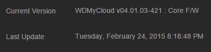

My Cloud Firmware

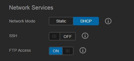

MY Cloud Settings Currently
Have a static IP for the my cloud working fine in all other aspects

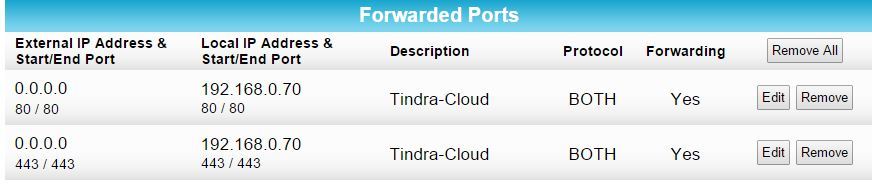

Ports: using Port 80 & 443 the standard.
The router I have tried port forwarding both using just the 80 and 443 and also at 9080 & 9443
Router port forwarding currently set at:

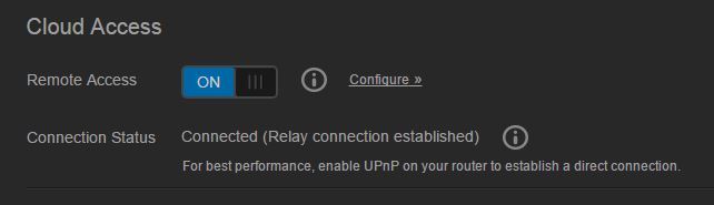

I have change back to DHCP and Auto for remote and after a couple of reboots in order then I now have remote access but a relay connection (at least, though this is where I wanted to NOT be, I want the true conection for Reliability and Speed)
Not sure if I want to try again or not I have spend the better part of the week in the evening trying any number of combinations to obtain a true connection … perhaps I should wait until the next firmware update and try again then …I seems a litte strange to groups …some are able to use upnp and static IP and port forwarding to maintain a true conecttion and then the ret of us just fall short and have problems.
