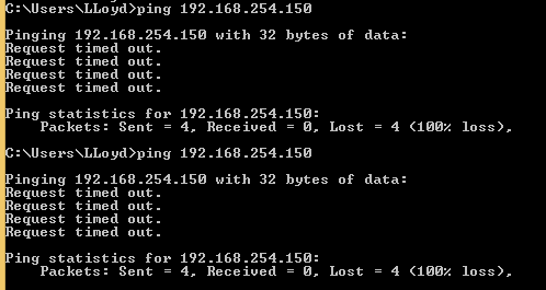

  8. unable to ping mycloud, results to request time out.

  1. Tried both via wireless and wired. Cannot ping amd access wdmycloud on both.
