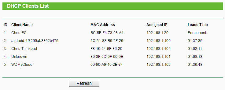

Decided to do 40s factory reset, solid white led for approx. 30 Minutes, now white flashing again. The reset should have worked, the router shows now the default hostname (see picture) and assaigned an IP to the Mycloud. Now i can ping my Mycloud, but accessing Dashboard isn’t possible (infinitive loading) either the shares are not accessible.
