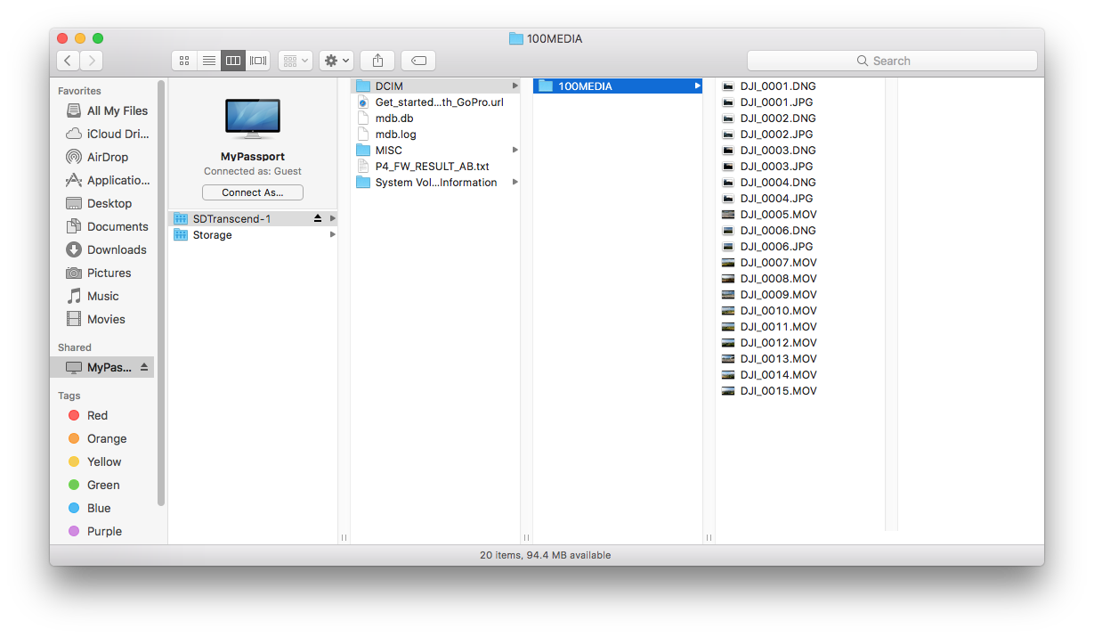

I have just bought a Tanscend RDF5 USB 3.0 card reader and give it a try. It works ! I could move 4K Phantom4 video files to WD Wireless PRO now without any computer or iPad . Moving 16GB files less than 10 minutes, which is ok to me.
Just want to share this with you. hope it would help you too.

i’m a bit confused. so if i understand this picture right…you managed to insert your memory card into the transcend to upload to the WD passport?
that seems odd, does that not require a computer?
i dont think you can use USB 3 to upload pictures to the WD passport - it reads from the SD port only. the usb is for connectivity/recharge only.

Hi John
Sorry for the confusion.
YES , it works without the computer now.
The screen shot just want to show the system recognised the Wireless Pro and Transcend Reader with Lexar 633X 16GB microSD card plugged into WIreless PRO USB port ( USB 3.0 and USB 2.0 use the same USB 2.0 host port. Not the one for charging and connect to the computer).
Before, the system can not see the MicroSD card 's content when it was plugged into Wireless PRO using SanDisk Adapter. It shows only Wireless PRO’s content ( “Storage” folder ). It means Wireless PRO cannot see the Micro SD cards and the adapter. I guesses it was the reason why Wireless PRO did not import the files on MicroSD Card.
