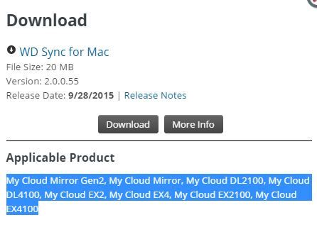

New/Update: WD Sync for Mac Version 2.0.0.55
The new/updated WD Sync for Mac is now available. It can be downlaoded from the WD Support Downloads by Product page or from the link below. If you have any problems or comments about this Mac software please post them below rather than starting a new thread.
WD Sync for Macintosh
File Size: 20 MB
Version: 2.0.0.55
Release Date: 9/28/2015 | Release Notes

It doesn’t see my MY BOOK LIVE DUO.
Firmware is up to date and I can get to the UI via the web browser.
Hi, WD sync seems that is not compatible with the WD My Book LIVE duo. Arre you sure the My Book Live Duo is your hard drive?
