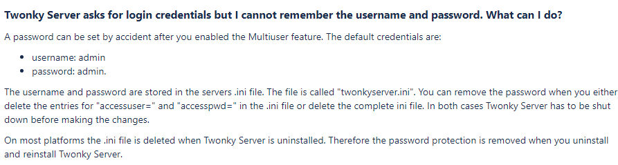

@Sornim Found this in Twonky Docs. Please let me know if this resolves your issue or not. https://docs.twonky.com/display/TF/Twonky+Server+FAQ+for+End-users
Thanks, I tried that to no avail, unfortunately. I read a potential solution though, further down that link, regarding deleting the server *.*ini file, but it’s not immediately obvious how that’s done, it states uninstalling Twonky removes those files, so I’m presuming there’s a /root dir that I need to remove or edit to avoid resetting the whole thing.
@SBrown. Okay, finally resolved the issue, and the error was in the “twonkyserver.ini” file, as mentioned in the link above:
“_https://docs.twonky.com/display/TF/Twonky+Server+FAQ+for+End-users
That’s the short answer.
The “twonkyserver.ini” file inherited an old or random username and generated a rather weird looking number-string as a password—basically no chance of ever guessing those—meaning, performing a fresh install of Twonky or implementing a quick NAS reset didn’t repair the file, as it just copied the same credentials. In this instance the *.*ini file inherited three instances where “accessuser=” and “accesspwd=” had conflicting entries, so when NAS_IP:9000/webconfig was launched, the page endlessly requested sign-in credentials.
Once those entries are deleted, Twonky launches normally. Obtaining access to the “twonkyserver.ini” was a bit of a headache though.
