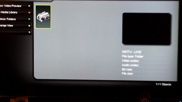

  3. After finish uploading the theme, i restarted my WDTVlive SMP and this is the first screen that appears:

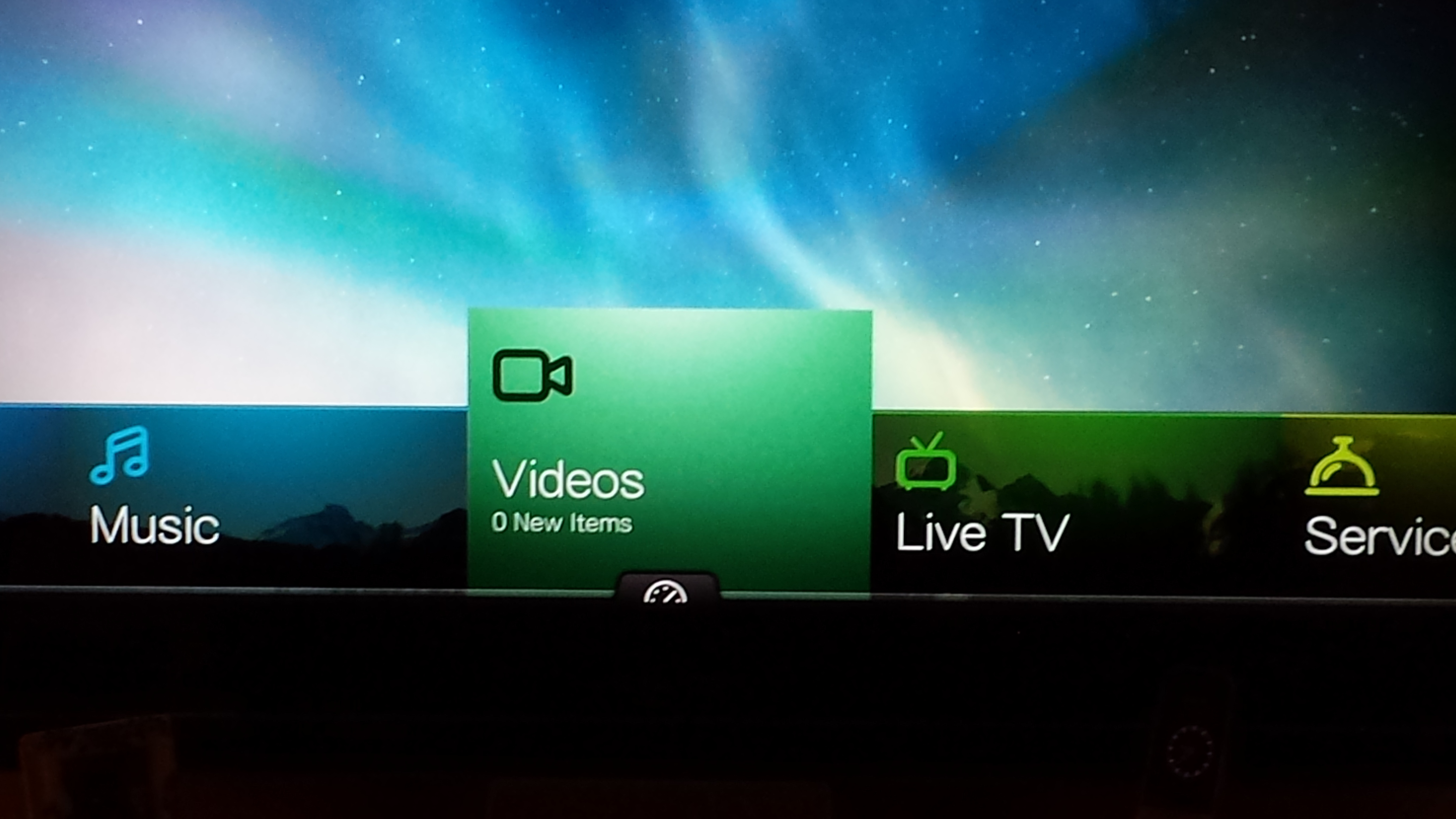

When I click on the Video button the next screen appears:

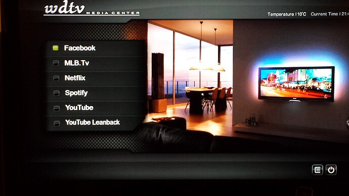

When I do the last steps of your ‘how to install’ from the first page I have this screen:
I think this is the Service screen. On this screen I can go up and down and setup button.
but no return, home, or other buttons.
I hope i’d explained things a little bit better and that you can help me.
Thanks.
Ok, i know what’s happening now …   PM4 WD Theme works as *intended*
When you upgraded to Firmware 2.0.2.32 … Western Digital introduced *another* built in Theme called " Grid"
The older WD theme is called " Mochi"
PM4 WD is a modification of the “Grid” Theme … as stated on Page(1) of my opening comments
PM4 WD - (A Non-Moviesheet “Grid UI” Modification Theme port of the Project Mayhem skin for XBMC)
Now, to use my theme … you must understand how to use " Grid" and what it does.
The Grid theme allows adding “Shortcuts” to Folders and Online Services.   ( Mochi theme does Not)
To add a Folder to the Home Screen … navigate to your Movie folder for example, then press the “OPTION” button on your Remote Control and select " Add Shortcut to Home Page"
To add a Service… press up   highlight “Services” Icon * browse for the Service you wish to add and as above press OPTION and add it to your homepage.
* Note: Services Icon is located Bottom Right in the PM4 theme
To Delete anything you don’t want on the Home Page press OPTION and select “Remove Shortcut”
In closing, practice … get familiar with how the Default (Grid) works and you’ll have a better understanding of how the PM4 WD Theme modication works.
