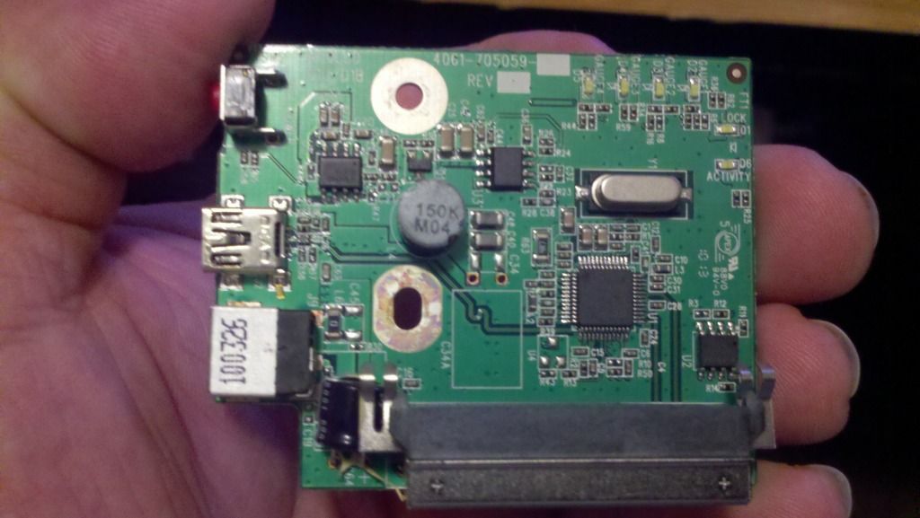

Okay so i accidentally plugged in my laptop cord into my 1TB My Book and now its not working. I’ve been searching and it sounds like its the 12V TVS diode where the only advice i can find is to take it out. Impatient me, i opened it, found a fried part near the power and took it out because as far as i know it cant do worse since it was fried crispy anyways. It looks like it was L4 or maybe J4 but it was illegible from burn marks.
I’m not sure what type of mybook i have but ive noticed it’s different from others ive seen where as their SATA boards (the green one right?) have more stuff on it.
Mine is MDL: WD10000H1U-00
Here’s a pic of the whole board:
http://img815.imageshack.us/i/img0110cz.jpg/

I’m not sure if this can be fix, I’ll suggest you to contact the user fzabkar he’s like the guru of circuit boards.
The photo is of the USB-SATA bridge board. L4 is an inductor. L4 and C14 appear to form a low pass filter that cleans up high frequency noise on the supply.
The 12V TVS diode, D4, is on the drive’s own PCB. There will also be a zero-ohm resistor, R64, close by.
I suspect that the overvoltage resulted in a shorted D4 on the hard drive’s PCB. The subsequent overcurrent then caused the failure of L4 on the bridge PCB.
The fix would be to remove D4, flow a blob of solder over R64 (if it is open circuit), and then replace L4 with a wire link.
Alternatively, you may be able to connect the drive to your motherboard’s SATA port. However, if the bridge chip at U6 is an INIC-1607E, then your data will be encrypted, in which case you will need to repair the bridge board, or replace it with one from an identical external HD.

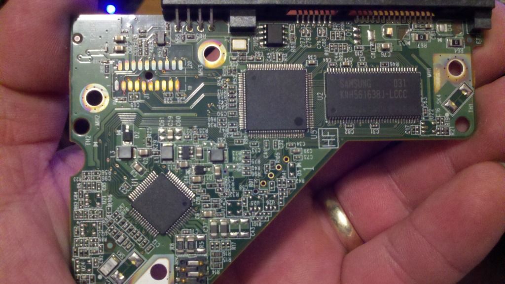

sorry but im not seeing exactly what the PCB is. Heres pics of everything thats inside the casing minus the USB-SATA bridge board since i already posted pics above.

You’ve shown us the uninteresting side of the PCB.
The interesting stuff is here:
http://www.24au.ru/photo/398/1990482.jpg
R67 and D4 are in the top right corner (D4 is just off the picture).
