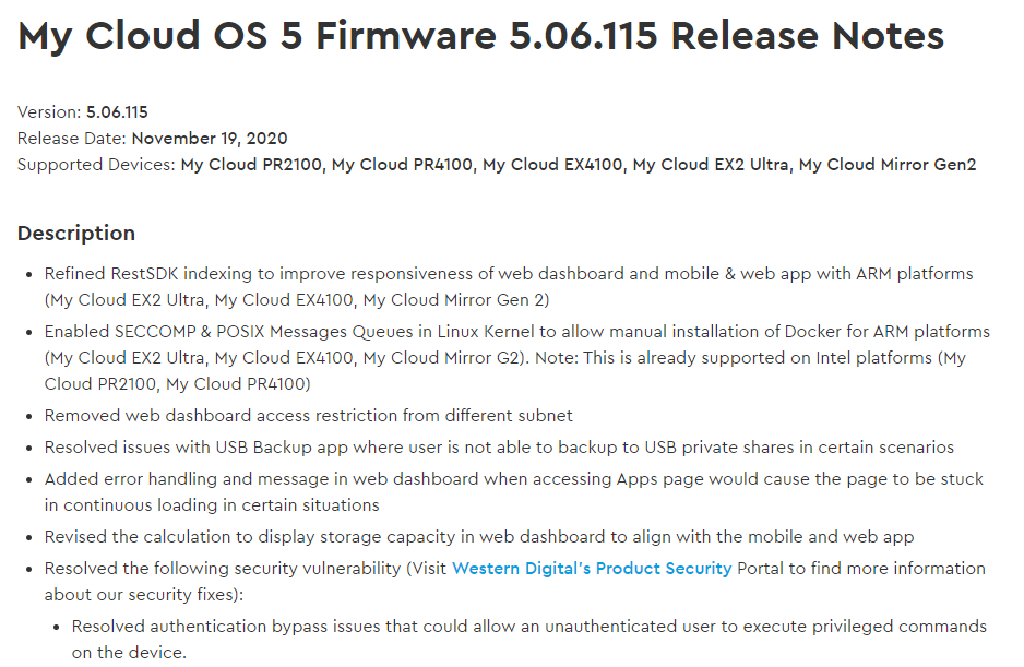

@Lildschwarz 5.06.115 firmware was released on 11/19/2020 and announced on the WD Community.
5.06.115 Firmware Release http://wdstagingsplit.staged-by-discourse.com/t/my-cloud-os-5-firmware-release-note-v5-06-115
My Cloud OS 5 Release Notes

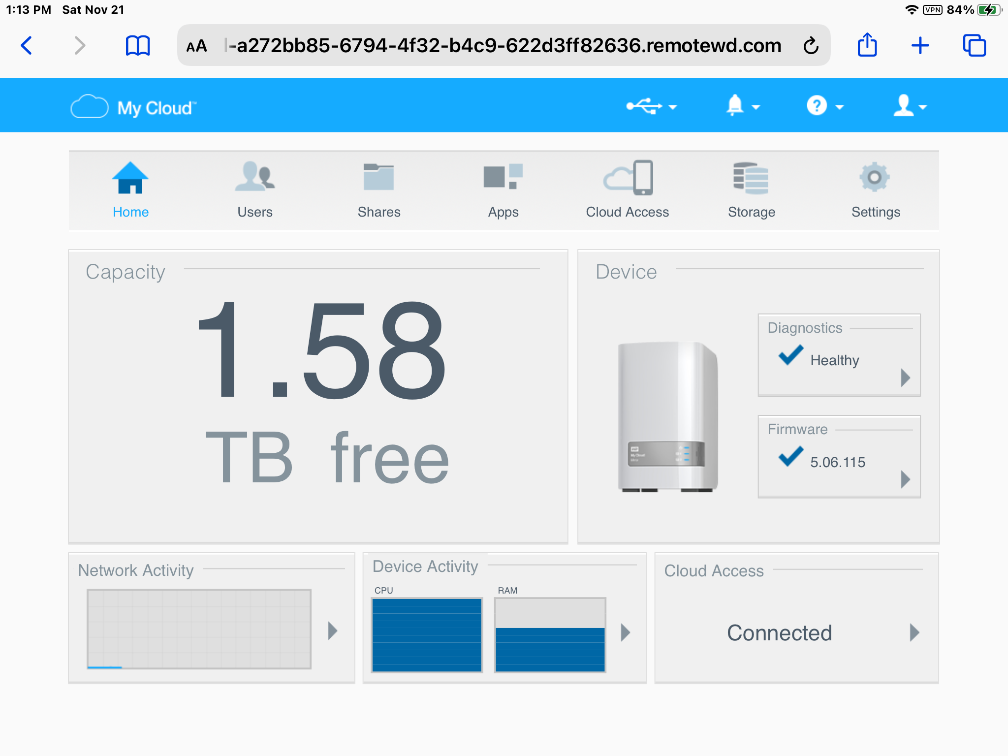

The manual update worked just as advertised. Drive is indexing, but much quicker and able to access via web/mobile.

Finally finished indexing!!!
