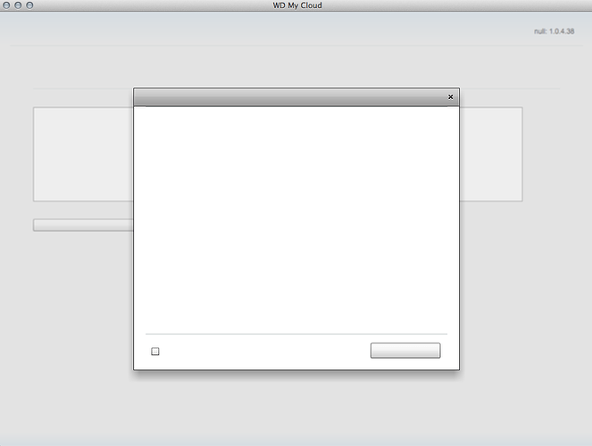

Software: tried to install the WD software WD My Cloud, but when it opens everything is blank… meaning no text and also no text in buttons. re-installing didn’t do the trick. Have this problem only on the Mac but works fine on Windows.
