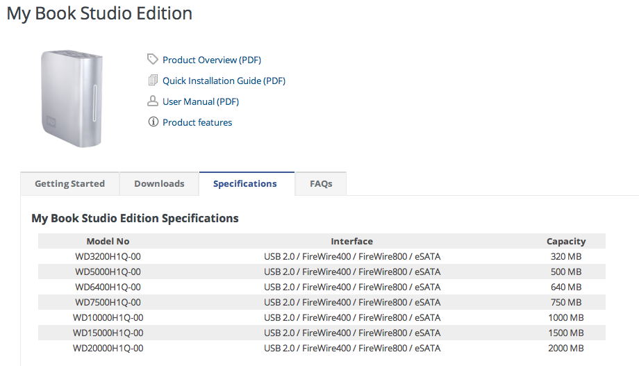

It is actually a My Book Studio Edition and it was sold in sizes up to 2000 GB. So the enclosure should be able to use drives up to that size.
