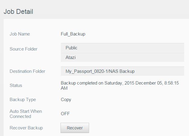

You can see my backup job info here:
Imgur
NAS has two 2TB WD red drives…unless your hardware is different (drive,
cpu, etc) it seems odd that yours would misbehave…Id RMA it and try again.
