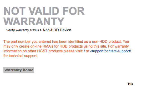

I’m getting this after entering the chassis SN. I tried entering the chassis PN as well but it’s not recognized. What should i do from here?
You’ll need to call in to support to get it manually created. 888.426.5214 for US based support.
