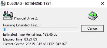

I just bought a WD 6Tb Nas Red internal drive.
I read on various forums that I should test my drive before using it.
First I made it GPT then formated it in NTFS.
After I downloaded and intalled “Data Lifeguard Diagnostic for Windows” from here :https://support.wdc.com/downloads.aspx?p=3
Now on the extended test, it seems to take for ages and displays me 164h remaining after 3 hours I wanted to know if this was normal :confused: ???
Thanks in advance for your feedback
Cotp
Hi Tistou
Try using Download Data Lifeguard Diagnostic for DOS (current version 5.27) it is a more reliable tool to use than Data Lifeguard Diagnostic for Windows.
Here are the instructions.
Follow the instructions to create a bootable USB.
Turn off you computer and remove the sata power connector from all the hard drives.
Connect the hard drive that you think may be defective or want to test.
Turn on the computer.
Set your bios to boot from a USB device.
Type dosdlg.exe
Select WRITE ZEROS TO DRIVE and do a full erase.
It should take about 12hrs to 15hrs depending on the computer (2 to 2.5 hours per tera byte).
It not only erases the hard drive but it also checks to see if it is working properly.
if the drive is defective it will come back with an error code that WD support wants for a RMA.
