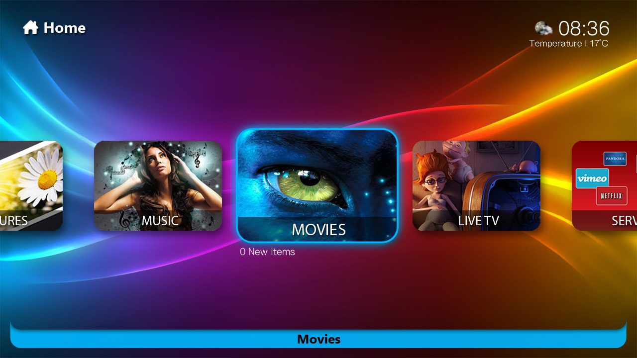

2nd Workaround: Removed the focused icons (done by resizing them to 1x1 pixels) which then leaves the non-focused icons to display with full transparency (but there will be no ‘pop-up’ or focus of the middle icon. The example below contains a back color focus that appears through the non-focused icons)
http://community.wd.com/t5/WD-TV-Live-Hub-Themes/My-Aeon-ish-Home-Screen-Experiment-Info/td-p/171368
Here’s the focused icon (a tiny 1 pixel dot)
