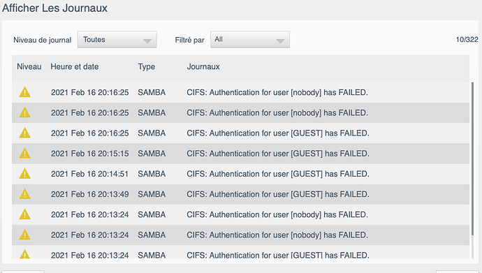

The journal reads as follow:

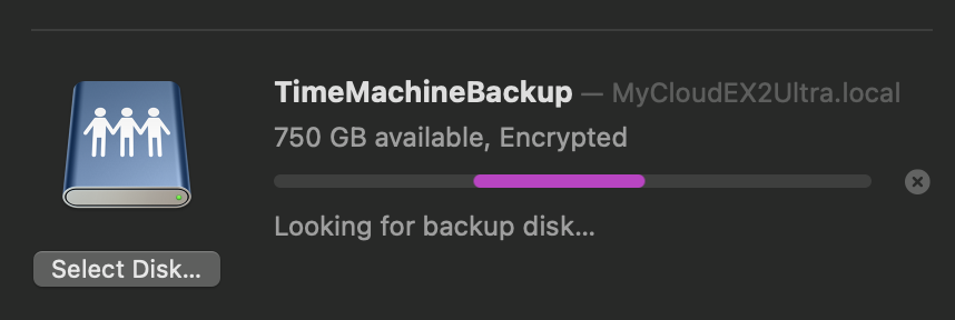

Nevertheless, I tried what you proposed (v2 + v3). Same errors. Even after restarting (see journal below). When reconfiguring TM, on mouse on, it shows the smb:// url. When choosing the disk destination, a first authentification panel shows up and fails silently after choosing guesst, another one shows up and TM proceeds but as AFP.
Both on Catalina and Big Sur.
Any idea?
I even tried after uninstalling ClamXAV (as there appears to have issues with Sophos) but no luck.
See image below.

NAS Logs: 2021 Feb 20 00:28:06 SAMBA CIFS: Authentication for user [GUEST] has FAILED.

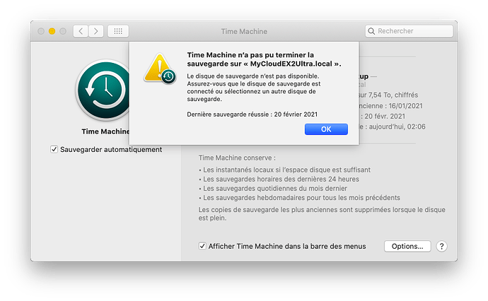

Lost a few days to get index done again but I am back with TM refusing to backup stating that the disk is not available…
This what I get from the macOS console:
erreur 01:19:59.419739+0100 backupd NAConnectToServerSync failed with error: 22 (Invalid argument) for url: smb://GUEST:@MyCloudEX2Ultra._smb._tcp.local./TimeMachineBackup
erreur 01:19:59.421241+0100 backupd Backup failed with error 19: The backup disk could not be resolved, or there was a problem mounting it.
And from the logs of MyCloud EX2 Ultra:
