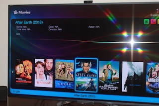

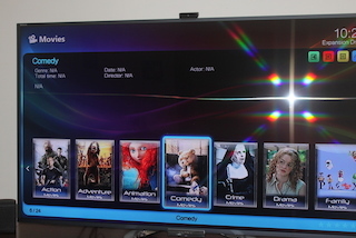

Hello I
 have my movies set up in genre folders and also in there own separate folder as well and I would like to
know how to remove the genre,date actor etc from each of the screens as in pics below.
This is a great theme I really love it and was also wondering if some background music could be added just an idea.
I have added some pics to see if anyone can help me i’m a newbie at this
can’t see the pics yet
turn off media library to get rid of genre, actor, etc …
no background music can’t be added by default
but you can start some music, and then browse your video library
