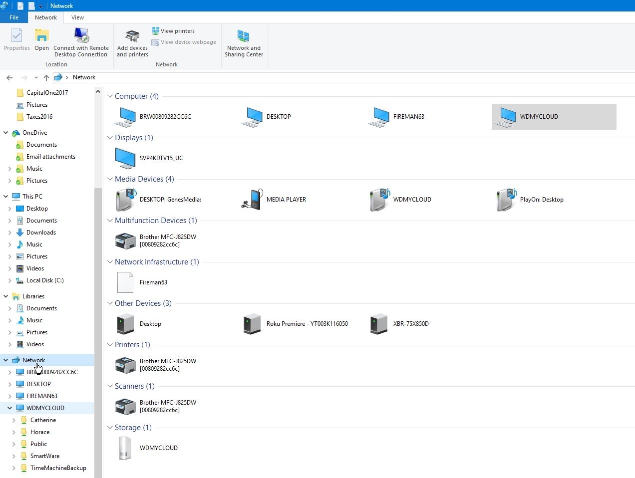

What is showing when you click on network? See image below. Click on, tap or activate image to enlarge it.

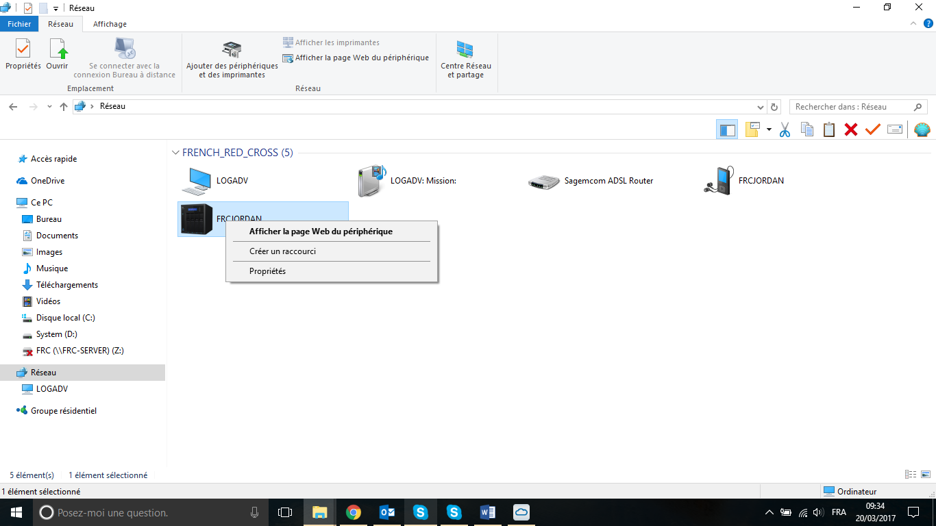

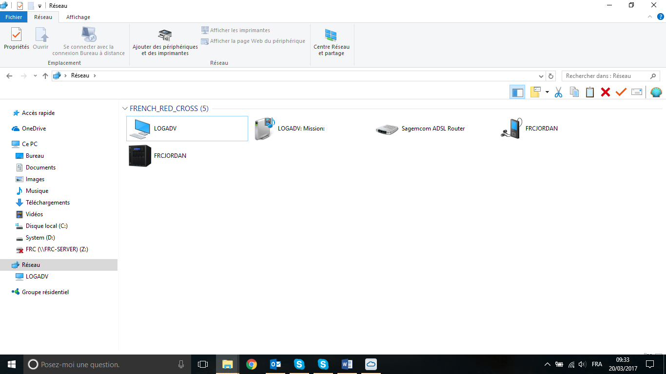

i already relaunch the My Cloud + the router + laptop. Still not working. This is how it is appearing on my laptop.
On the Icon frcjordan it’s just giving me the possibility to open the website or to connect on the Mycloud as Admin

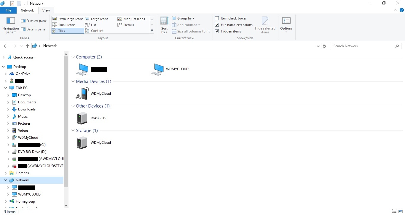

The Windows File Explorer View > Group By layout looks different than the default. Try changing the Windows File Explorer View > Group By to Category. It should then structure the icons by categories. For example the categories should be: Computer, Media Device, Other Device, Storage. One then double clicks on the My Cloud entry under Computer. Here is an example:
If you do not see any entries for the My Cloud devices under Computer then double check that; the My Cloud units each have a unique name, that each device on the local network are using the same local IP address range, that if using WiFi that it isn’t isolating the wireless network from the wired network, that each My Cloud has a static or reserved IP address, that NetBIOS over TCP/IP is enabled on the laptop, that the local network group for the laptop is set to Private, that File and Print Sharing is enabled on the laptop.
Try accessing the My Cloud using the My Cloud IP address rather than its text name. Sometimes one has to hit the “refresh” button in Windows File Explorer to trigger a refresh and have the My Cloud(s) show up correctly under the Computer category.
