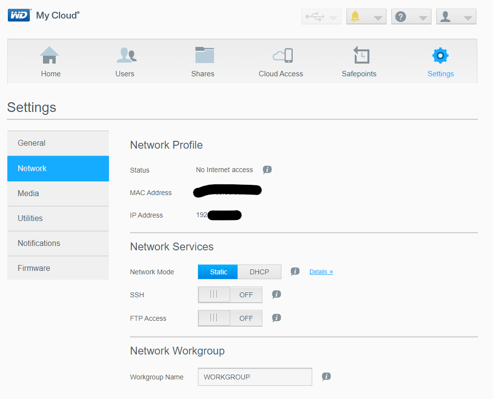

In the Dashboard, Settings>Network what do you have showing?
Below is what mine is showing and I use it only on my Local network.

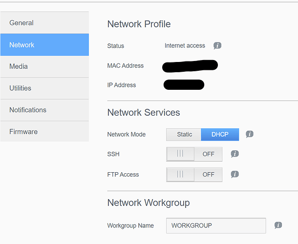

Thanks for the reply. That is what I would like to see, but this
is what mine looks like.

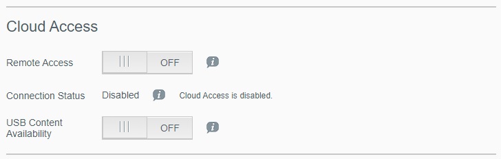

Normally one would check the My Cloud Dashboard > Settings > General > Cloud Access section for the remote access connection status. If one wants to disable Cloud Access, then set Remote Access option to OFF. The connection status should indicate Disabled. Note: Any time one reboots or powers on the My Cloud they should double check that Remote Access is still set to OFF, sometimes it may be re-enabled when the My Cloud is rebooted/powered on.

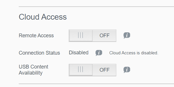

The settings I have changed are the following
But as you can see on my screen grab above, the network Status still says there is Internet access.

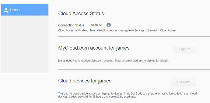

The other settings I have changed are these

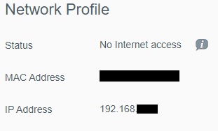

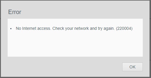

The My Cloud tries to access the internet for other things besides Remote Access/Cloud Access. This includes NTP to set the My Cloud’s time, and the My Cloud tries to check WD servers for firmware updates. The reason why cat0w screen grab shows no internet access is because they are likely blocking the My Cloud at the router/network firewall level. Mine shows the same, no internet access, when I block the My Cloud at my router:
As previously indicated, when blocked at the router firewall the My Cloud cannot check for network time so the time has to be set manually or one has to reconfigure their router/network to either run a NTP server or allow NTP traffic through the router firewall to the My Cloud. And if I try to manually check for a firmware update with the router blocking internet access to the My Cloud I get the following error:
We don’t know for certain what changes WD will introduce with their supposed firmware update they indicate will be released when they terminate OS3 support next month. They may disable all My Cloud services that access the internet or they may just block remote access/cloud access.
