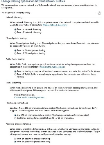

All comments that follow refer to Win7:
There is a way to check, and change the workgroup name.  In control panel click on System.  You will see the workgroup name.  Off to the right you will see a way to change it if necessary. Click and you can change things.  Since the WDTV defaults to WORKGROUP, suggest your PC workgroup is same name.
Homegroup:  To control to use/not use Homegroup,   from Control Panel, go to Control Panel\All Control Panel Items\Network and Sharing Center\Advanced sharing settings, and find Homegroup and select not to use Homegroup, (lower option), i.e. select “Use user accounts”, etc…
Here is a screen shot of how my advanced settings are set, (except for the last option, Homegroup – not enough room in screen shot)  I have my settings to not require passwords, (and WDTV set that way, too) as mentioned in my other link in msg  about network sharing.
   I have to say I am at a loss as to how mapping a network destination to drive on a PC will be picked up by my WDTV, especially when that PC is turned off? (Mind you, off or on, it still does not work!).
You need to understand the subtle differences of SERVERS and SHARES:  If you devices are shared via a certain PC, then that PC needs to be ON to see shared devices on your network.  If they are servers, the PC does not need to be on.  I have devices that are either servers or shares, and in a couple of cases a device is BOTH (e.g. WDTV), and why we can see it under either condition – but the WDTV acts differently with either case.
Good luck!
Thanks, Mike for taking all the time to provide this comprehensive info.
My settings now match yours.The lead you gave me to the network settings hidden in “System” was very useful. Why can’t all these settings be together?!
