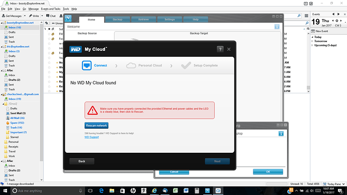

With you screen shot I went into the Configure Cloud Access area and found I may have some setup here to complete. I tried downloading the WDMyCloud desktop application for my PC laptop ( believe it is the same applicaqtion I took this following screen shot from) and was unable to locate my My Cloud device.
Here is what I get from the My Cloud Ap on my laptop, even though I can obviously get to the My Cloud because I am completing backups in the SmartWare share.
