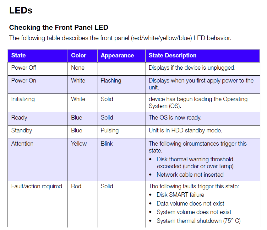

What is the model number of your drive? There isn’t an orange LED on any of the My Clouds, but there is a yellow one on the original version of the My Cloud. Here is a description of what the various LEDs on that model mean:
Ahh. Good call.
Is it yellow-- Attention, insert cable!
or is it red-- Attention, Sheit got real!!
Inquiring minds want to know!
Well… It isn’t the best of color monitors… It could be considered a solid yellow (which isn’t on the spectrum) or white. But nothing seems to be downloading. I don’t know what to do about it. I have rebooted and reset. I don’t know what’s left without loosing the data. I need the data!
