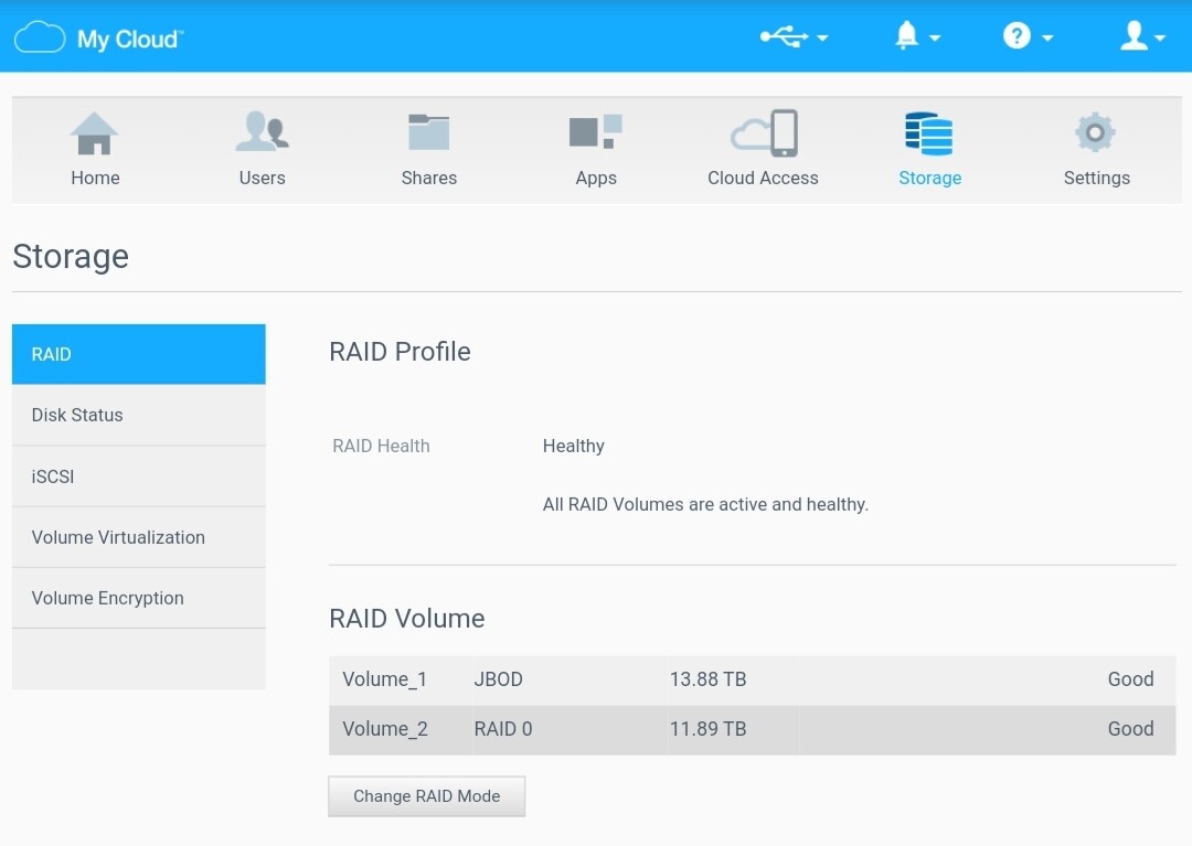

For some reason I’m getting a “Bad” health on my drives now. Have the 14TB as JBOD, volume 1, and the two 6TB as RAID0, volume 2.
How do I fix the bad health? The 14TB is brand new.
It came back with no errors found and still showed bad…
I decided to take the 14TB drive out so I could format the 6TB’s as JBOD from RAID0. That went well and they say good health. Plugged back in the 14TB and now that has become volume 3 and still shows bad health…
