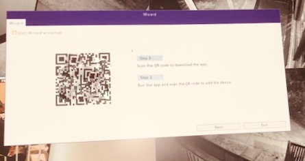

I am trying to monitor my WD ReadyView on my TV. When connecting the ReadyView to my TV using the HDMI port, I get the camera monitor screens with an overlay of instructions to install the app. Has anyone made this work or know the purpose of the HDMI port?
You can close this “Wizard” {click Exit} then see your camera live feed(s). You can right-click and change the number of feeds to show (e.g. 4).

I recently bought a Viewsonic PC monitor. When I plug the WD Readyview in via HDMI (or DVI), it brings up the Wizard asking me to scan the code and download the app. However, this is just a monitor, there is no ability to to even use a mouse to click out of the Wizard. This notification will not go away and it blocks the cameras.
Is there a way to fix this? I’m also looking into the IE plug in and the iOS app, and there doesn’t seem to be a way to disable the wizard…
You can disable to wizard in the setting. I think it is in the 3 tab from the top. I’m at work and could not remember to tab name.
You have to plug a mouse to your surveillance box and use the mouse to click the exit button.
