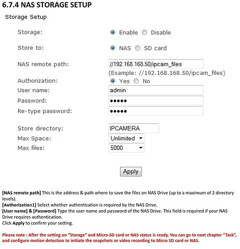

FYI: These are Trivision NC-335PW-HD1080P camera’s I am trying to connect here. Cameras are working great with local storage (SD card) and through Android app.
Page 45 of the Manual : http://www.twistidea.com/downloads/TriVision%20Manual%2020141024.pdf
The notation to use is slightly strange
//IP-Address/share

As such there is probably a problem with the way you have configured the camera to access the My Cloud. Do you have a User setup (with password) specifically for the camera? Is the IPCAMERA_0 Share set to Private? If so is a User configured for Full Access to that Share? Have you used the Public Share folder as a test location to save the camera video? Have you experimented with the various options from the camera’s NAS Storage Setup screen? My guess is the NAS remote path would be JUST the IP Address of your My Cloud and the Store directory would be IPCAMERA_0.
