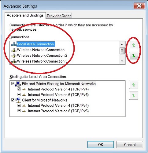

Though I still cannot see your screenshot but as TonyPh12345 mentioned above, the reason you are probably getting such slow speed (as possibly many others are) is because you are likely using the wifi connection. In Windows 7, even if you have a wired ethernet cable plugged in, I realized over a year ago that for laptops (which almost all have wifi today) the default connection used is wifi - if for some reason wifi fails THEN does Windows 7 switch over to wired connection. And obviously a wired connection will give you much higher speeds - wired connection is the whole pupose most of us wanted to use a NAS in the first place. To use wifi to transfer files defeats the purpose of having a NAS hooked up to your network via a wired connection.
BTW, to check wthther or not your Windows is using wired connection when plugged in, go to Network and Sharing Center control panel and then from menu choose Advanced → Advanced Settings (see pic below or this alternate pic is it’s not visible below →   http://imgur.com/mcPuqy7 )
Then in Advanced Settings ensure that Local Area Connection is listed at the top of connections (like in pic below or in this alternate link → http://imgur.com/tfoFjQF )- IF IT IS NOT then use the arrows on the right (circled in the pic) to move the Local Area Connection to the top of the list. ONLY THEN will your Windows computer be using the wired connection over wifi anytime the cable is plugged in.
In addition, you are using RAID 1. RAID 1, which performs simultaneous identical writes on both drives will especially hurt the speed of writing files. So combine RAID 1 write speed with a wif connection and you will get a pretty dismal speed, even on newer AC wifi routers than compared to wired connections with JBOD mode. There are always going to be tradeoffs - do you want to use wifi for convenience over wired for speed? Do you want to use RAID 1 for drive redundance (data protection from failures) versus JBOD for speed? Only you can make those decisions.
