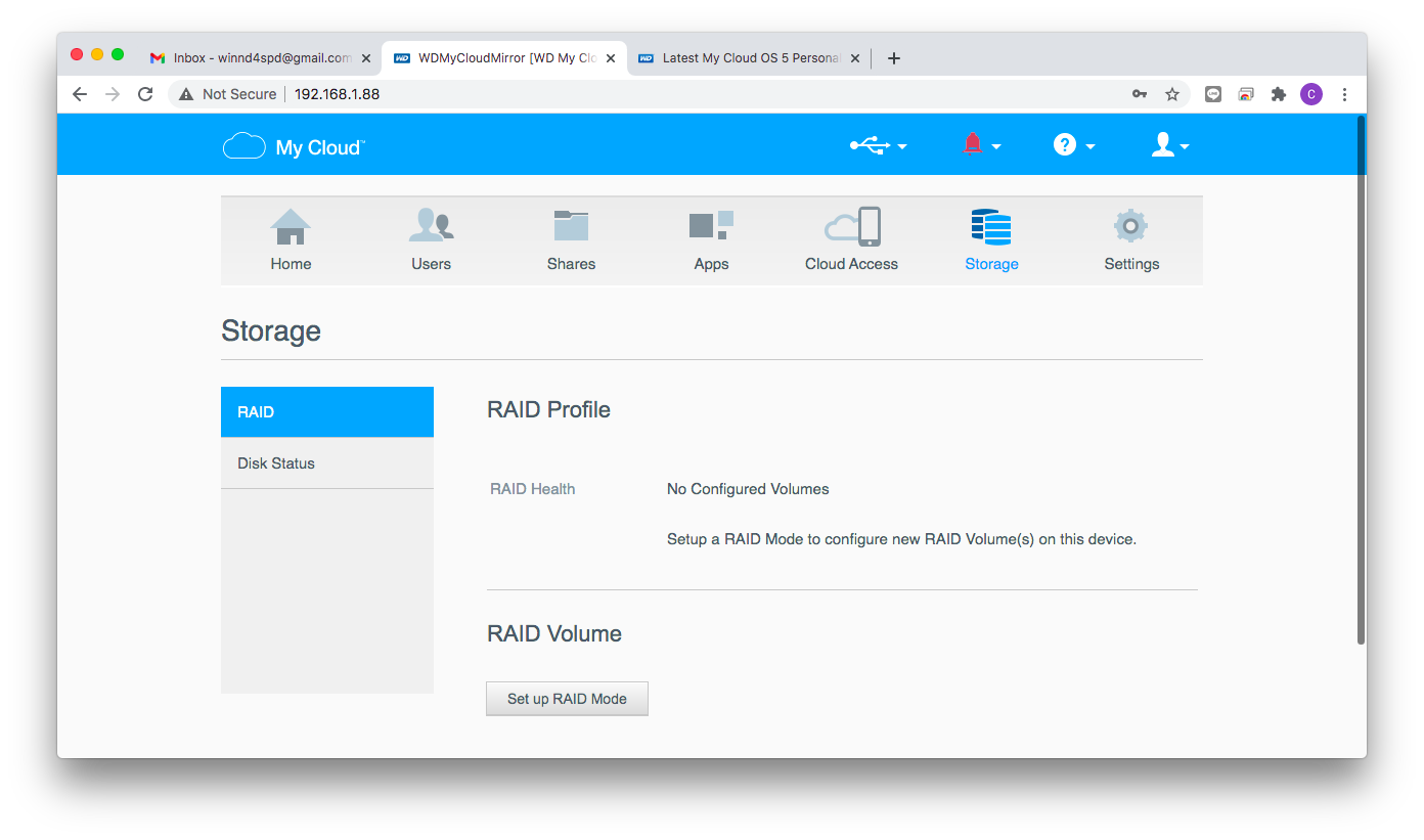

I have just upgrade my My Cloud Mirror 2 to OS5 5.05.111. The process completed successfully without any errors messages. I was able to rest my user (creating new password) and access the dashboard. However, later an “Volume Failure. The data volume 1 on the drive is not accessible. Code:4” critical error message appears. The HDD LEDs turns red. Capacity turns to 0.00 MB free and I could not access the drive on local network to get the data at all.
I check the storage tab and it says “No Configured Volumes. Setup a RAID Mode to configure new RAID Volume(s) on this device.”,“Disk Health: Healthy”
I used the drive normally before the upgrade in “Spanning Configuration”.
Please help me to sort this problem out or tell me how to! get my data out. Many thanks!
Screen Shot 2020-11-23 at 02.07.59|690x406
@winnd4spd What size HDD and Volume did you have configured with your Mirror Gen2?
Mirror Gen2 shipped from the factory with a max of (2) 8 TB HDD in RAID1 so a max of 16 TB volume total.
Did you have a volume larger than 16 TB?
Hello @SBrown,
Thanks for your reply.
I have 2X10TB and was running spanning of total 20TB on it previously.
Are there anyway I can fix it or get my data out in this situation?
@winnd4spd Unfortunately, My Cloud OS 5 doesn’t support a volume larger than 16 TB on the My Cloud Mirror Gen2 so it cannot mount the volume. One solution would be to upgrade the enclosure to an EX2 Ultra which does support larger volumes in OS 5, or if you have a backup, reconfigure the disk with RAID1 and 10 TB Volume.

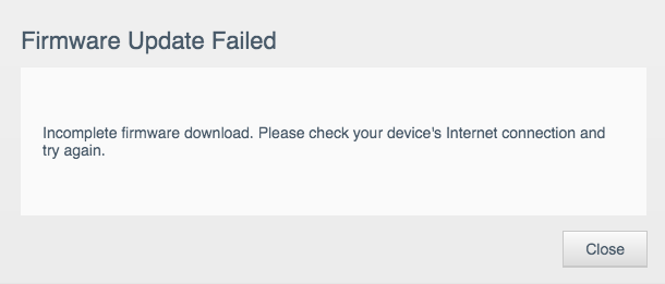

Thanks @vendo232,
That’s absolutely a break though. However, I’m not sure whether WD has blocked it on the new OS5 as I faced an error while trying to upload the bin file via Web GUI as bellow:
Hope you can help me to pass though this step
