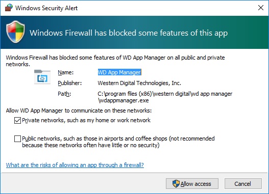

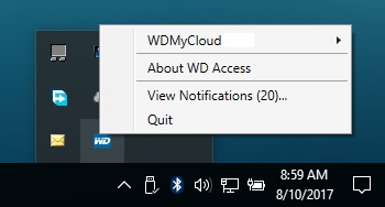

WD Access is working on my end in Windows 10 (with a first gen single bay My Cloud).
Have you let WD Access through the firewall on Windows 10? Upon clicking the Access icon after installing it I got a popup indicating I had to grant access through the Windows 10 firewall.
Yes, the first time I installed it it asked for that, and I did.
Curiously, after uninstalling and then re-installing, it did not ask the question again.
