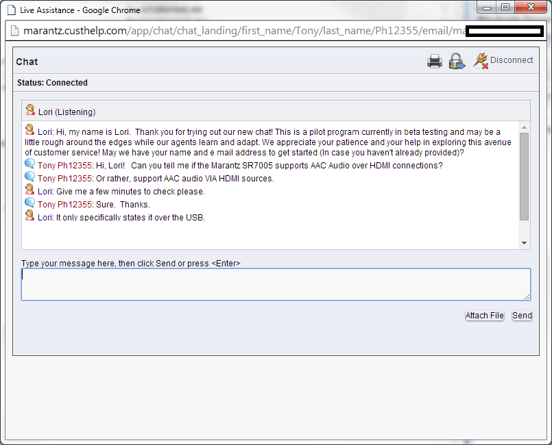

LeeC2202 wrote:
I have also had confirmation from Marantz support , that the receiver is compatible, and it was them that suggested it might be the player that was the problem… which they were correct about.
Hmmm. Ok… I “confirmed” the opposite:
LeeC2202 wrote:
I also have an Oppo BDP-103, and that plays the videos to the SR7005 with the audio intact, so that confirms it.
According to Oppo’s own documentation, the Oppo BDP-103 does not support AAC passthrough.

Here’s the reply I got back:
“Thank you for your enquiry. The SR7005 is not able to play multichannel audio via either the network sources or via the USB connection unfortunately, only by HDMI or Digital Optical / Digital Coaxial input.”
They said that because they presumed I was streaming from source to the SR7005 direct. Once I told them that the video was being played from another player, they then suggested the player might be at fault.
It’s great that you got *confirmation*, but perhaps it would have been better to pose the question more *specifically* to Marantz. What you asked was a bit ambiguous, so it’s no wonder you got back limited, and incomplete information. I say that because the manual also states that AAC is a compatible format from a media server, just just USB… in stereo mode, which is what it only plays via USB. The SR7005 is not a video streamer, but it does stream pure audio, and that is why AAC is specifically mentioned in the audio playback sections of the manual. If you put a video file with stereo audio on a USB, it will just play the audio part.
As for the Oppo… the manual states: “Input - HDMI Audio: up to 5.1ch/192kHz or 7.1ch/96kHz PCM, Dolby Digital, Dolby Digital Plus, DTS, AAC.”. So it takes AAC in through its own HDMI in connection, but I can’t confirm what it does with it, only that it plays back fine on the SR7005. I would have to pose the question to Oppo, as to whether any processing/conversion goes on, when AAC files are played from the player.
Needless to say, I am none the wiser, but based on Lori’s comment, it seems I’m not alone in that.
