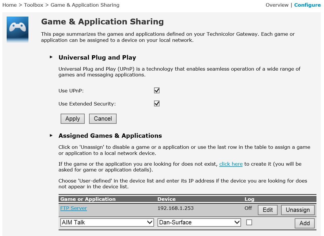

Thanks - I have started working through this and have got as far as step 5. I am not sure how to work out the External Port 1 and External Port 2 numbers. I do have this option in my router control panel:
Where the drop down menu shows âAnyâ I can select a protocol - either TCP or UDP, which should I choose, or should I leave it as âAnyâ?
And do you have any advice what information I should include in the rest of the boxes, how shoudl this read? Sorry, networking is not my strong point at all!

But since your router has already upnp enabled, go back to your wdmycloudâs dashboard settings, toggle the cloud access->remote access off (wait few secs) then on again. You should be able to access your cloud remotely if thereâs no error.
Try setting the port forwarding manually. I donât know what is your router brand and model, but Iâm guessing see below:
From your previous router screenshot (I canât see the 2nd port forwarding screenshot as the mods still havenât approved) go to, âGame & Application Sharingâ â âAssigned Games & Applicationsâ â click the link " âclick hereâ to create it ". It should ask for few things, like new name, device IP, ports and protocols. Give it a new name of your choice ie. wdmycloud. Then the device IP should be your wdmycloudâs lan IP. Set the port to 9080 TCP. If it allows multiple ports, give another 9443 TCP, else repeat the steps to add another port 9443 TCP.
Go to your wdmycloudâs dashboard âSettingsâ â âGeneralâ â click âconfigureâ â select âConnectivity=manualâ â input âExternal Port 1 (HTTP)= 9080â â input âExternal Port 2 (HTTPS)= 9443â â click save. Toggle the remote access off then on again.
