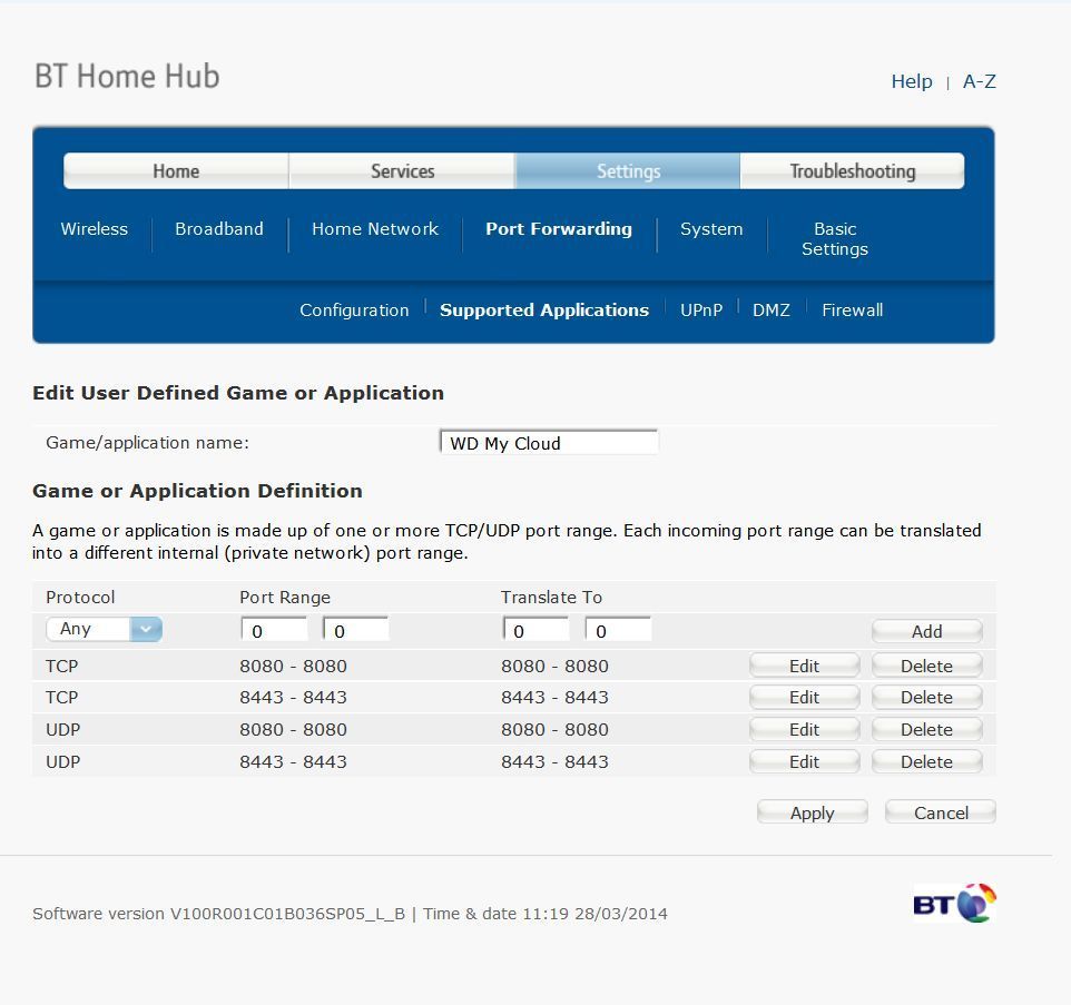

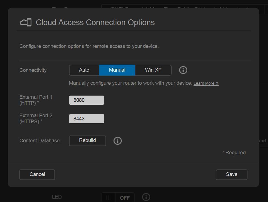

I’ve followed all of the suggestions in the forum:
- Changed MyCloud - Settings - General - Configure Cloud Access to Manual

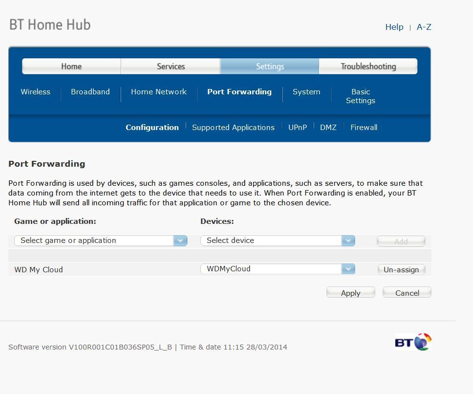

- I added the required ports to my home hub
- I allocated that to the MyCloud device
- And finally added DMZ access
Cloud Access still fails. I have checked the firewall log on the router - no messages, so it has not tried to stop this. Along the way, I’ve changed the time and date to what it should be in the UK, changed the timeserver to the same on e used by my homehub, so that they are in sync. Each time I have changed remote access in the WD MyCloud IP page to Off, and backl to ON. Each time it fails. I’ve turned the WD MyCLoud off, and left it 30 seconds, then plugged it back in.
