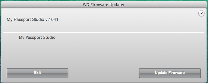

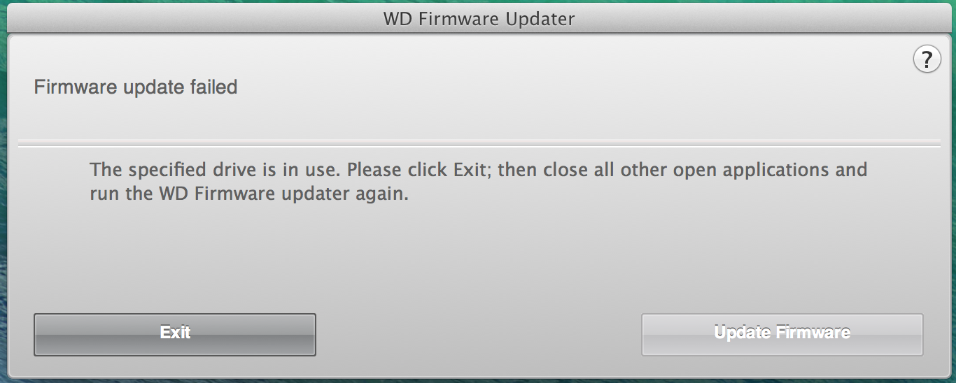

Hi i have Passport studio i was trying to update the firmware, but after i was failed updating i found out that it was not mounted anymore. But when i re-try to update it the firmware updater still detected my drive.
