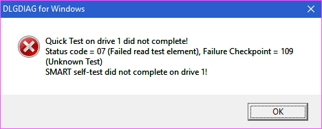

Test Option: QUICK TEST
Model Number: WDC WD30EFRX-68EUZN0
Unit Serial Number: Deleted by Moderator
Firmware Number: 82.00A82
Capacity: 3000.59 GB
SMART Status: PASS
Test Result: FAIL
Test Error Code: 06-Quick Test on drive 1 did not complete! Status code = 07 (Failed read test element), Failure Checkpoint = 109 (Unknown Test) SMART self-test did not complete on drive 1!
Test Time: 10:42:05, June 11, 2017
The extended Test start and show “Bad Sectors” … then i press repair.
After that i run the Quick Test again and the same message “… did nit complete!”
SMART Status: PASS
Test Result: FAIL
Test Time: 10:54:30, June 11, 2017

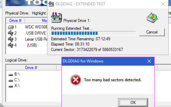

Test Option: EXTENDED TEST
SMART Status: PASS
Test Result: FAIL
Test Error Code: 08-Too many bad sectors detected.
Write Zeros to the hard drive to completely clean it and attempt to repair bad sectors. This is of course data-destructive. If the unit still has bad sectors after a full erase then it should be replaced.
