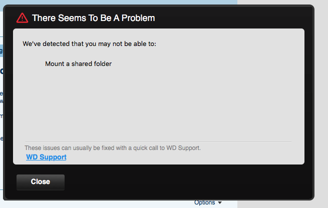

My EX4 auto updated itself and now I can no longer get it to mount as a network drive on my MacBook Pro. Ā It worked fine up until the update. Ā ALL of my media files about 5TB worth are sitting on this and now I can’t get anything. Ā Not happy at all.
I too am having this problem since the update.
I’ve been locked out from my drives today now too since the firmware update.
27" 2013 iMac
OSX 10.11 (El Capitan)
I can log into the web admin just fine. View and access files from there, but now there is no way to connect to the drives in the system browers. Tells me unable to connect. Same IP addresses. The drive is recognized and shows up fine everywhere else. Even the My Cloud EX4 software sees the drive but is unable to access to make the file browser connection.
I really need to access these files.
It now is showing me this (attached image)
Ok, I was able to fix my connection issues by enabling these two settings which were off (either always or now due to the firmware update). AFP Service and WebDAV Service.
