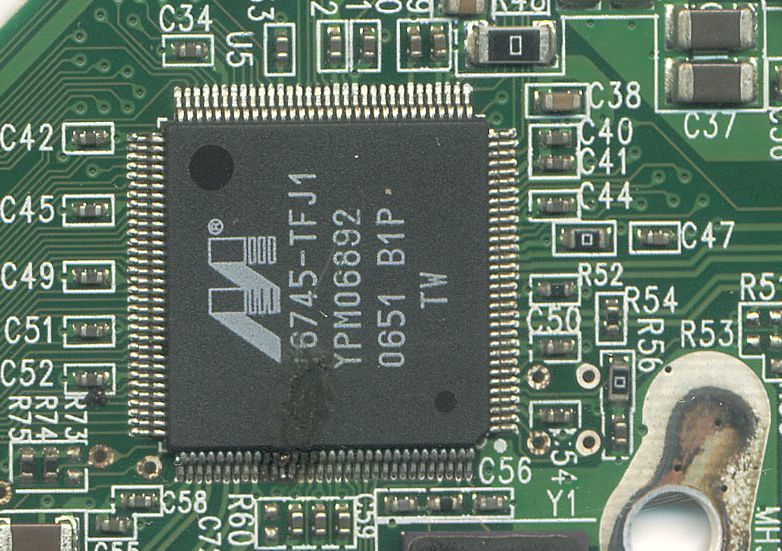

Your board’s “adaptive” data are embedded within the Marvell 88i6745 MCU. This means that you will need a PCB adaptation service to rebuild the flash memory in your replacement PCB.
Depending on the damage, it may also be that the preamp inside the HDA is damaged, in which case your HDD will require a headstack replacement.
Can you measure the resistances of D4, D3, R64, and R67 in the following photo?
http://www.users.on.net/~fzabkar/HDD/bigcircuitboard_diodes.jpg
Use the 200 ohms range of your multimeter.

The diodes and resistors measure OK, so there does not appear to have been an overvoltage on either of the +5V or +12V inputs as I originally suspected. Also, I cannot see any damage on the motor controller IC. Therefore I believe that the preamp is most probably OK.
Instead, the damage to the MCU looks like the kind of damage I have seen when a user has plugged a floppy drive power conector into the drive’s jumper block. Is that what you did?
In any case, a replacement PCB is unlikely to work without an “adaptation” service. This means that the MCU’s embedded flash data will need to be reconstructed from backups in a hidden System Area (SA) on the platters. This requires special data recovery software such as WDR-UDMA. Otherwise, if you are prepared to ship your drive overseas, you could try asking at The HDD Oracle forum.

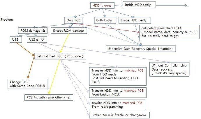

I’m getting started comfusing. I made a diagram.
Actually I’m not sure " matched PCB" part of diagram.
Sorry I think picture link was broken, I linked again. again.
Diagram was not correct info. because of my misunderstanding.
The short answer is that there is probably no DIY solution for you. However, there may be someone at The HDD Oracle forum who will help you if you are prepared to ship your drive to Europe.
