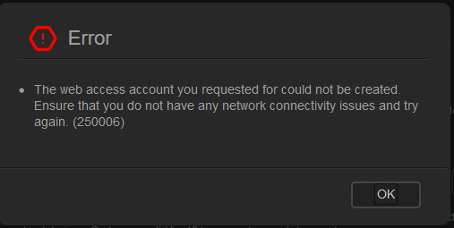

I´m trying to sign up an account for wdmycloud.com and it doesnt work.
Connection status = Ready and Cloud access is now availabale for my device.
I was trying different eMail-adresses and accountnames.
Do you have any suggestion to help me for a successful sign up ?

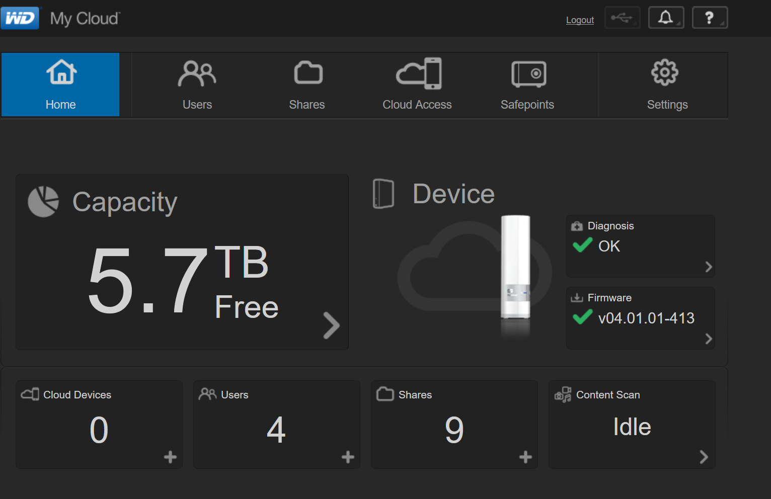

Update your My Cloud firmware to the latest version. Your screen captures appear to indicate you are using pre WD OS 3 firmware. Older versions of the firmware, pre WD OS 3 firmware, may not support remote access or the MyCloud.com web portal.

Thanks for your suggestion, but I was updating firmware two days ago.
MyCloud-Dashboard says “v04.01.01-413”

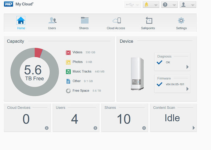

The latest v4.x firmware for the single bay My cloud is 04.04.05-101 (12/13/2016).
https://support.wdc.com/downloads.aspx?g=904&lang=en#firmware
Firmware is now “up to date” - but i still can`t sign up!

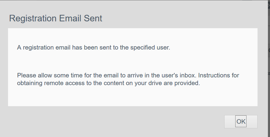

Now it works :slight_smile:

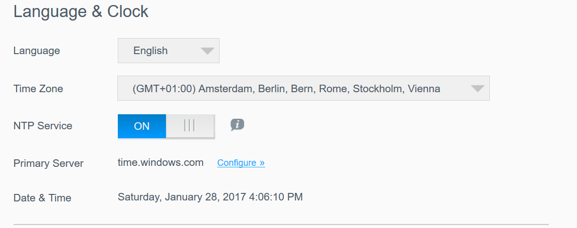

The problem was a wrong date !! Date was “26.11.2016” !! Since I changed my date to:
it was possible to sign up !!!
