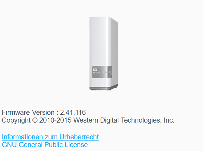

My primary browser is Firefox 87.0 (64-Bit), uBlock origin installed but deactivated for http : //192 . 168 . 2 . 2/ (which is a static IP), other addons: Brief, Open selected links. I use a restrictive cookie setting.
Other browsers: the very same phenomenon with Chrome 89.0.4389.114, no addons, all cookies allowed, Opera 75.0.3969.93, Edge 89.0.774.63 (64-Bit), even with IE …: orange cloud icon, no text.
Windows version is Windows 10 Home 64-Bit, 20H2, 19042.870
MyCloud version:

I would like to upgrade now. Still the issue is the same. All I see are windows without text, only buttons to click on. HOW can I judge what I am doing when there is no description that I could read? Could anyone PLEASE offer help?
No matter which browser, no AddOns, no VPN. I am connected via WLAN and no, I am not able to connect via LAN cable because I am physically handicapped. Maybe the text resources are local to the device but it still seems to me that simply the German translation is missing. Can I switch to English language resources?
Found it, switched to English, no difference: empty window!
