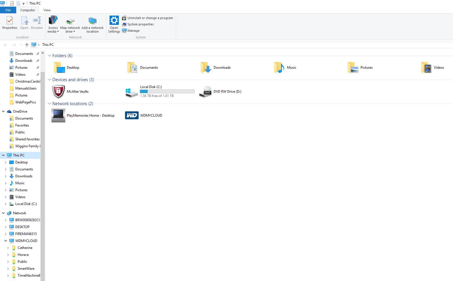

Do a restart of your computer and then see if it shows up under This PC. See image below. Click/Tap or activate image to enlarge it.

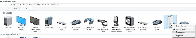

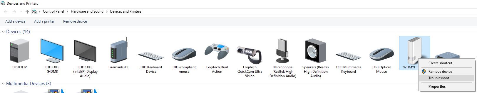

Have you tried to troubleshoot your My Cloud. Click in the Cortana box and type in devices and printers. If your My Cloud shows up do a right click on it and then troubleshoot… Maybe this will help. See image below. Click/tap image to enlarge it.
