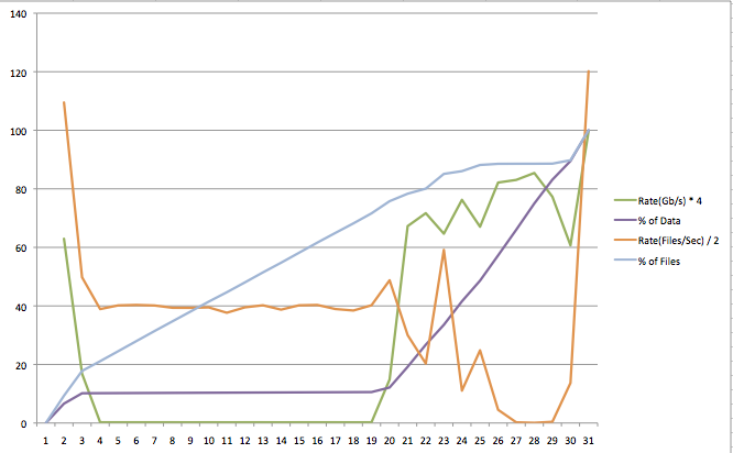

My initial assessment of the problem was wrong - the backup wasn’t stalling, it was simply taking a very long time to progress when it hit a large number of small files.  After spending a couple of days with the System Log I have a reasonable idea of what has happened. After backing up 86GB of data (1785293 files) in 3 hours it then took 16 hours to back up a further 2GB (10.2% of job to 10.5% of job) (approx 500000 files in total or 3% of files per hour) and then completed the remaining 765GB in 12 hours.  Total files 8454638.
I am not using the WDMyCloud for external access, so am happy to use the Time Machine Share in a public mode as any attempt to mount the share with user/password was failing when TM tried to redo it.  (Just to avoid confusion I did have the user password enabled and full access for the user authorised in the share.)  WD had recommended the secure option, and also to mount using cifs://, but that didn’t work for me.
I attach a chart of the data I gathered below.
