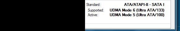

Are you sure? Because in HD Tune it says:
Can’t see the picture.
I’m pretty sure that your motherboard contains SATA 2 ports and by setting a jumper to a 5-6 pin position it limits the drive from original SATA 600 to SATA 300, as it can be seen on the image (you may have noticed that while setting a jumper).
I can’t see the picture, either. However, I wonder if you can infer the interface speed from the burst speed in the read benchmark.
Hmmm, strange, I can indeed see the picture - but nevermind, it is from HD Tune and under the “info” tab it says at the bottom right: “Standard ATA/ATAPI-8 - SATA1” - the other one, my Samsung HDD says “SATA2”. I can be wrong but I think I on the Hard Disk itself there stood nothing on the label concerning the jumpering part.

Thank you, I really overlooked this on my drive :-/ - but nevertheless, why says HDTune it is a SATA1-device? And the speed in the test is also relatively slow or isn’t it?
