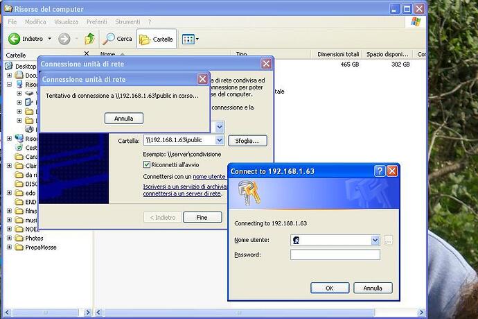

If I try to open \WDMyCloud\public, I receive error.
If I try to create a drive linked to WDMyCoud I seem to go through, but the PC then asks me for some username and psw. I tried every combination, but could not satisfy its request.

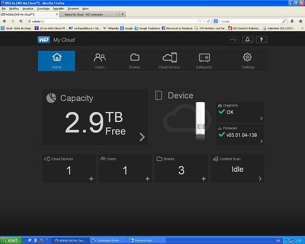

Anyway, I successfully installed the WD Quick View, and can manage the Dashboard with no issue.

just click OK… See what happens. I’ve had this happen to me before. I assume that your public folder has is accessable to all right? That is how you set up the permissions in the Dashboard right? If so, then just click OK and ignore the request for USER and PWRD. You might have to click OK a few times.
Also disconnect all the mounted drives you have with the WD in Windows Explorer Computet. Then reboot your PC. Then remount the drive and then jus tclick OK to ignore. You’ve got some kind fo residual thing going on with Windows. it’s not a problem with the WD
Sadly, also this method didn’t work. What had given me few chances is that when asked for a username, if I only type the PC username, it adds my WD network name, with \ before it.
For example, if I type “edo”, it immediately changes it into “WDEdo\edo”. Therefore, I assume it really asks for a WD network user and psw, not my PC’s one.

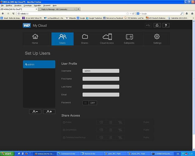

type: y when prompted and try connecting to Public. Also, just to make it easier on everyone, can you post screenshot of your user and shares dashboard setting?

Hello, I had the same issue at first. Your problem is you have not set a password for your WD My Cloud user (admin). In your screenshots of your \User\ tab, the only user listed is “admin” and the Password is “Off”. You will need to create a user account and set up a password, or do what I did and edit the admin account (I changed the username from admin to my pc’s username) and then turned on Password and set up the password. These are the credentials being asked for when you are mapping the drive.
From your screenshot It doesn’t appear as though you have any Private shares. I’d suggest doing the following:
Edit the admin user to have a password for your admin account
Create a private share, and make sure you give your user account full access
