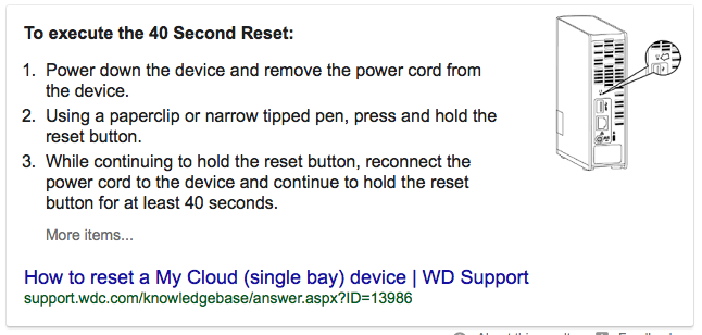

You will need to do the 40 second reset. This will reset the ip to DHCP.
16 AM
You have to do this correctly and I mean it takes three hands. One to hold the my cloud, one to press the reset pin continuously throughout the 40 seconds and one hand to plug the power cable in (use something that has a switch).
